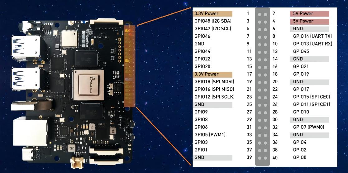

The 40-pin header allows StarFive single board computers, including both StarLight and VisionFive, to interface with a variety of external components, which enables developers to create their projects. This document is intended to:
introduce the 40-pin header as described in this chapter.
provide instructions to configure and debug GPIO, I2C, SPI, PWM, and UART, as described in Preparation, GPIO Operations, I2C Operations, SPI Operations, PWM Operations, and UART Operations chapters.
provide peripheral examples to use 40-pin header, as described in Peripheral Examples chapter.
The following figure shows the location of the 40-pin header. The VisionFive board is taken as an example:
Figure - 40-Pin Definition
The following table describes the GPIO pinout, the map and explanation of what each pin can do:
Table - GPIO Pinout

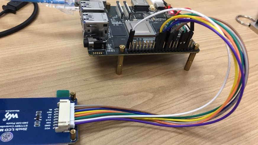

| Peripheral Example | O | - 2inch LCD Module - Dupont Line | - |

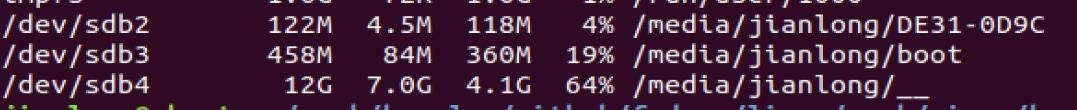

The SD card used to flash the images identifies the following directories:
Figure -Identified Directories

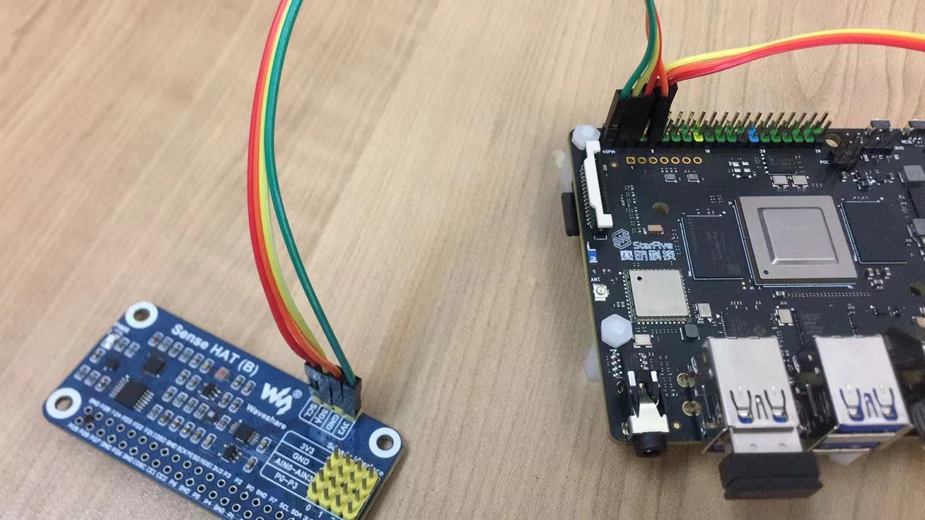

Connect the Sense Hat (B) to the header as the following:
Figure - Connect the Sense Hat (B) to the header

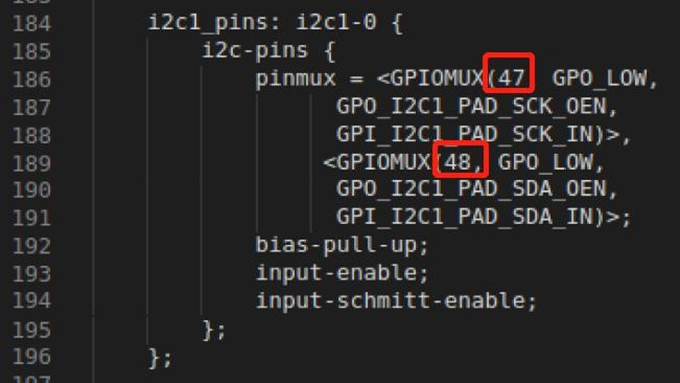

Modify the file content of jh7100-common.dtsi under /linux/arch/riscv/boot/dts/starfive. The following is the default setting. You can configure the unoccupied GPIOs as required.
Figure - Example File Content
Information:
The I2C GPIO pin number is the number indicated in the Pin Name. For more details about the GPIO Pin Name, see the GPIO Pinout section in this document. The pin names of the I2C GPIO are listed as follows:
- GPIO48 (I2C SDA)
- GPIO47 (I2C SCL)

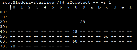

Execute the following command to detect the device:
i2cdetect -y -r 1
Information:
1 is the I2C bus number.
Figure - Example Output
In this figure, the detected devices are 0x29, 0x48, 0x5c, 0x68, and 0x70.

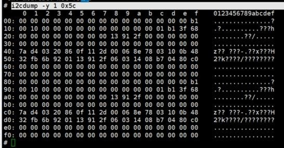

Execute the following to read all register values:
i2cdump -y 1 0x5c
Information:
1: I2C bus number0x5c: I2C device address

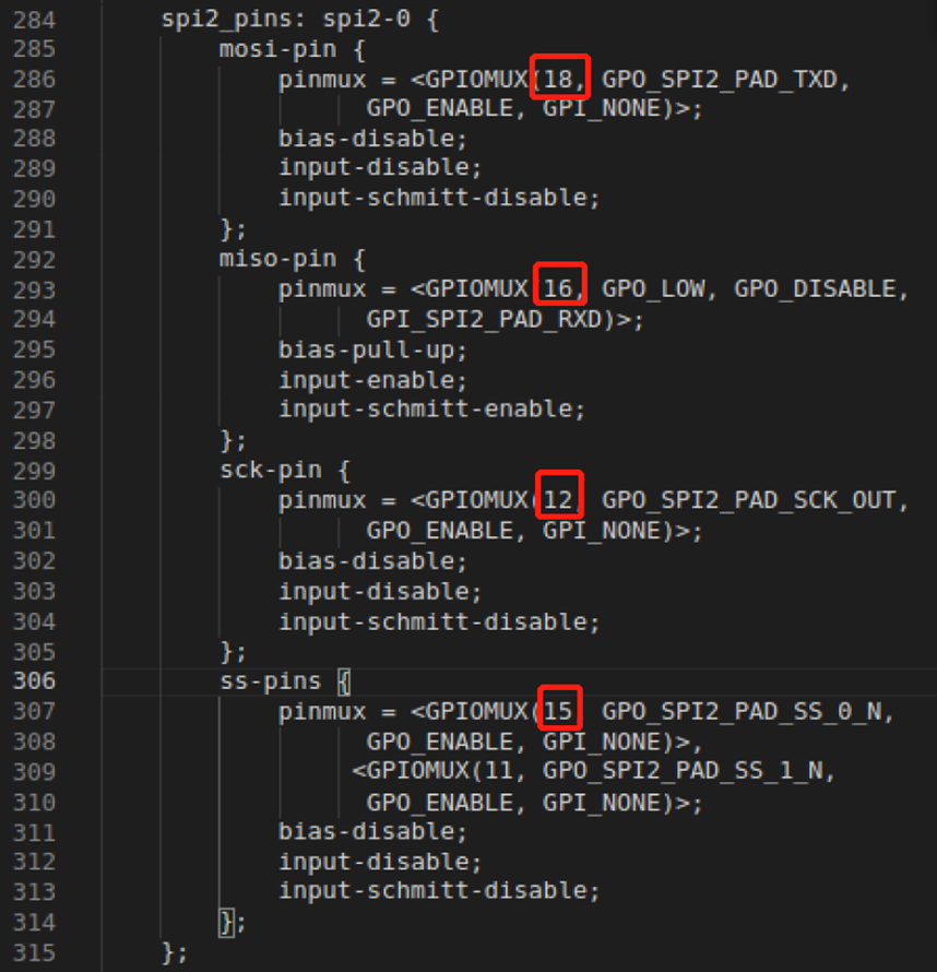

The configuration file, jh7100-common.dtsi, is under /linux/arch/riscv/boot/dts/starfive.
2 channels of SPI bus are supported: spi2 and spi3.
The configured SPI GPIO number is the number indicated in the Pin Name. For more details about the GPIO Pin Name, see the GPIO Pinout section in this document. You can configure the unoccupied pins. The following is the default settings in the jh7100-common.dtsi:
Figure - Modify Pins

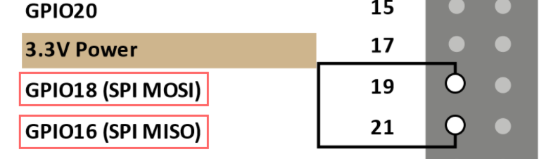

The following steps are provided for loopback test:
Wiring: Connect GPIO18 with GPIO16 as the following:
Figure - Connect Pin 18 with 16

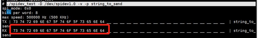

Execute the following command to perform the test:
./spidev_test -D /dev/spidev0.0 -v -p string_to_send
Information:
spidev0.0is the device name got from the previous step.
In this figure, the highlighted part indicates the test is successful.

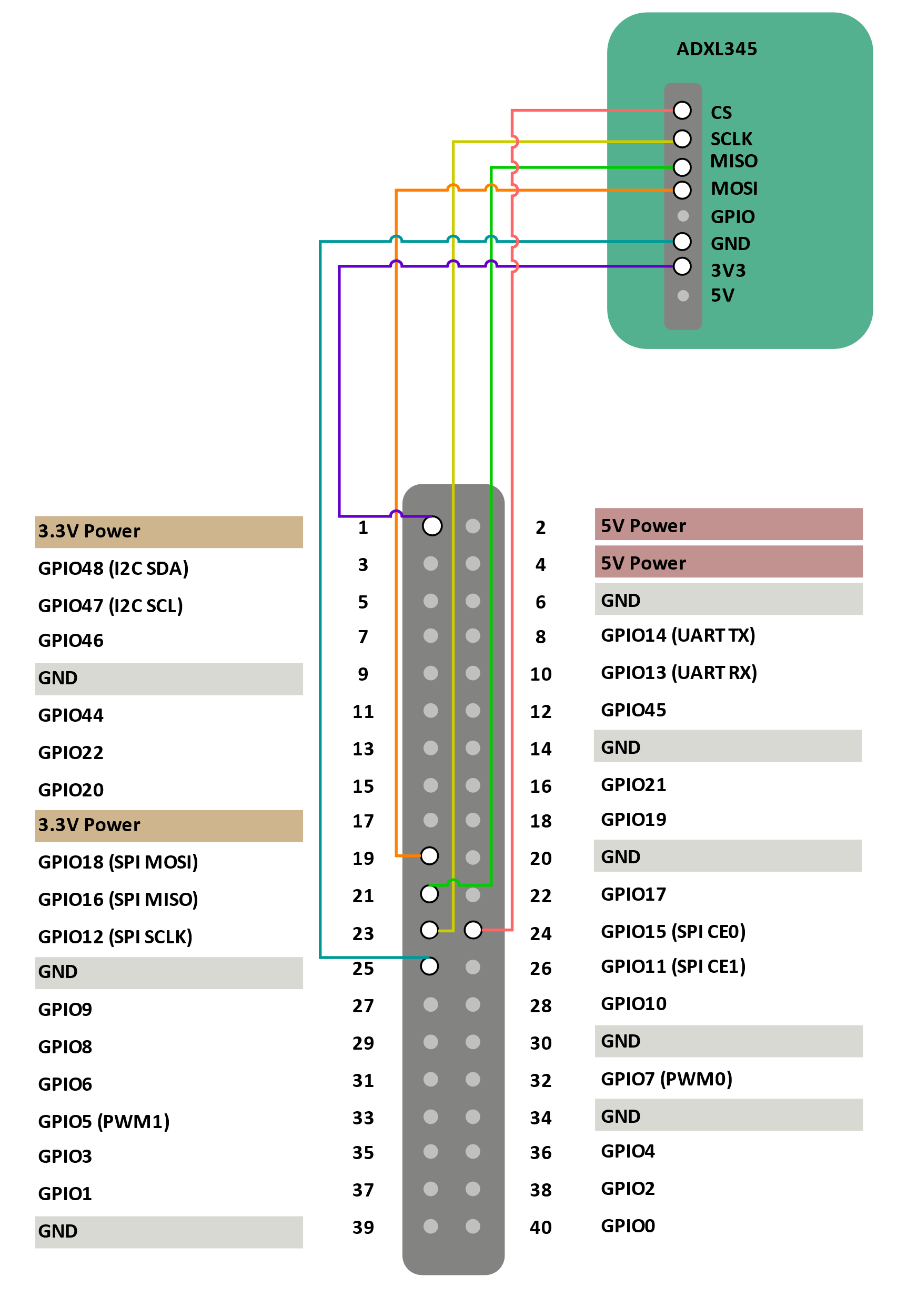

Perform the following steps to test SPI with ADXL345 module:
Connect the ADXL345 module to the 40-pin header as the following:
Figure - Connect ADXL345 Module to the Header

Execute the following to read the device ID:
./spidev_test -H -O -D /dev/spidev0.0 -v -p \\x80\\x00
Execute the following to read the value for multiple registers:
./spidev_test -H -O -D /dev/spidev0.0 -v -p \\xec\\x00\\x00\\x00\\x00\\x00\\x00
Execute the following to read:
./spidev_test -H -O -D /dev/spidev0.0 -v -p \\x9e\\x00
Execute the following to write:
./spidev_test -H -O -D /dev/spidev0.0 -v -p \\x1e\\xaa
Execute the following to read the verification:

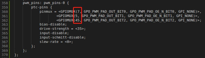

The configuration file, jh7100-common.dtsi, is located under /linux/arch/riscv/boot/dts/starfive
8 channels of PWM are supported at the most.
The following figure shows the example file content to modify pin:
The configured PWM GPIO number is the number contained in the Pin Name. For more details about the GPIO Pin Name, see the GPIO Pinout section in this document.

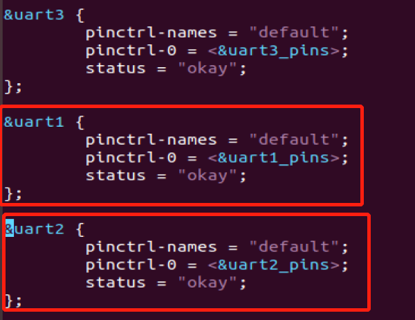

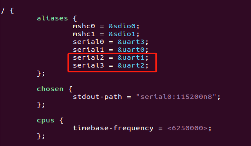

To modify dts file, perform the following steps:
Add aliases of uart1 or uart2 on the aliases node. The following is an example:
Figure - Example Configuration
Add uart1 or uart2 node on the dts. The following is an example:

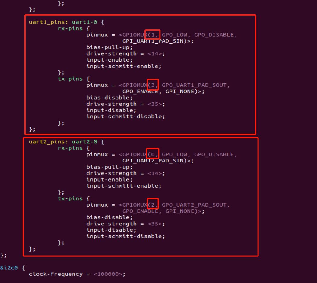

Add uart1_pins or uart2_pins node on the &gpio node
The configured UART GPIO number is the number contained in the Pin Name. You can configure the unoccupied pins. For more details about the GPIO Pin Name, see the GPIO Pinout section in this document.

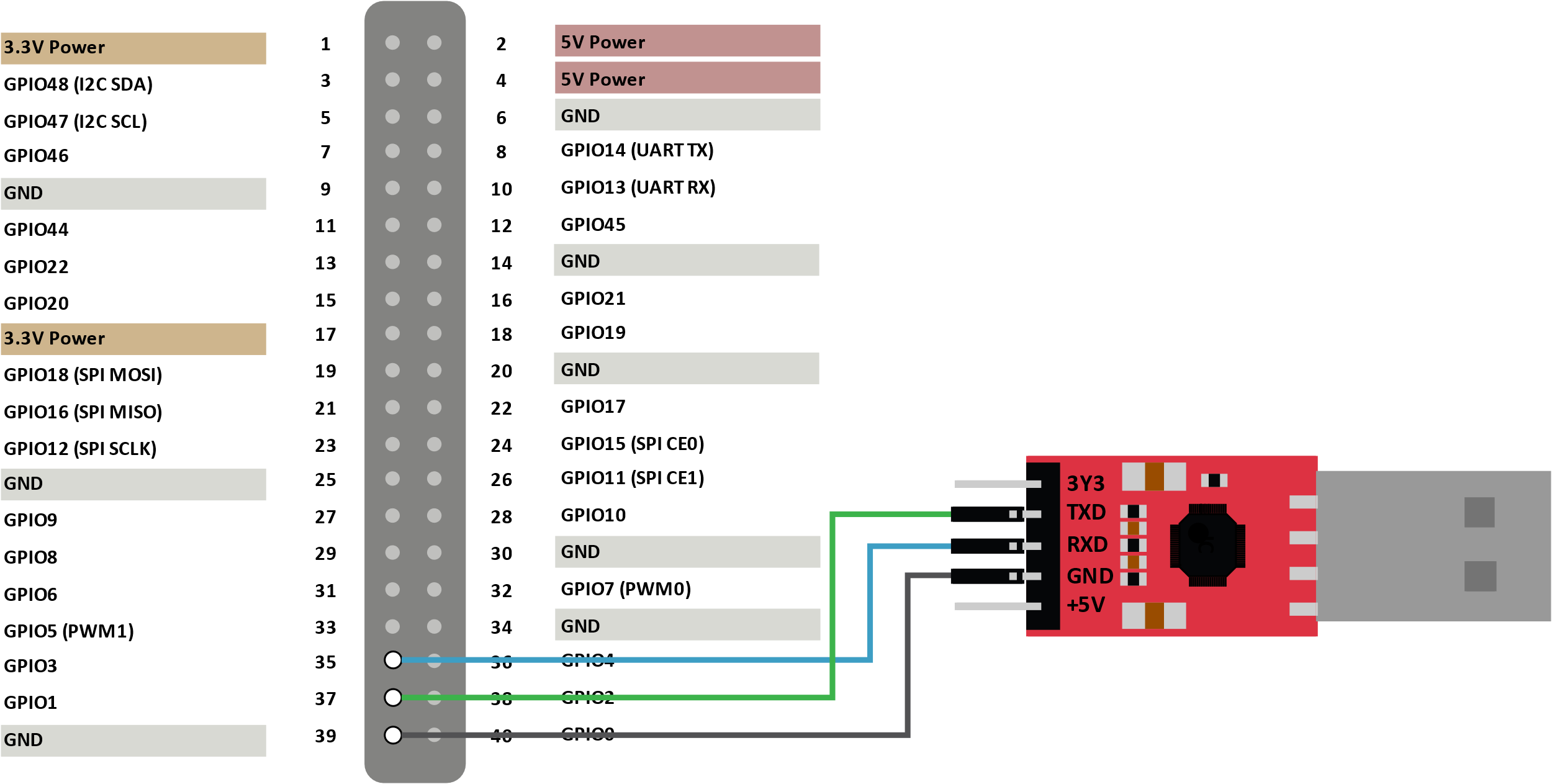

To set up the hardware, perform the following steps:
Steps:
Connect the jumper wires from the USB-to-Serial Converter to the 40-Pin GPIO header of the VisionFive as follows.
Figure - Connect the Converter to the Header
Connect the other end of the USB-to-Serial Converter to your device (PC/Ubuntu).

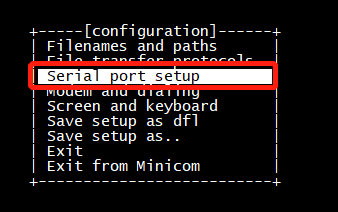

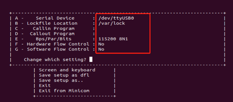

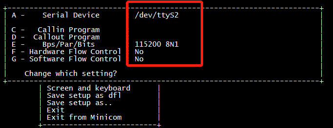

Configure Visionfive minicom
sudo minicom -s
Select Serial port setup, and configure minicom as follows:

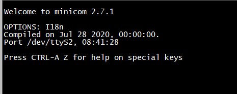

Start Visionfive minicom by typing the following command:
minicom -o -D /dev/ttyS2

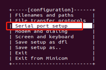

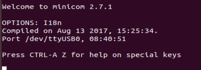

Configure Ubuntu minicom by typing the following:
sudo minicom -s
Figure -Example Configuration

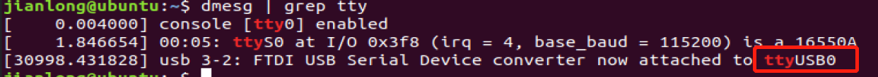

Information:
Serial Device can be detected by commanddmesg | grep ttyon Ubuntu
Start Ubuntu minicom, you can see as follows:

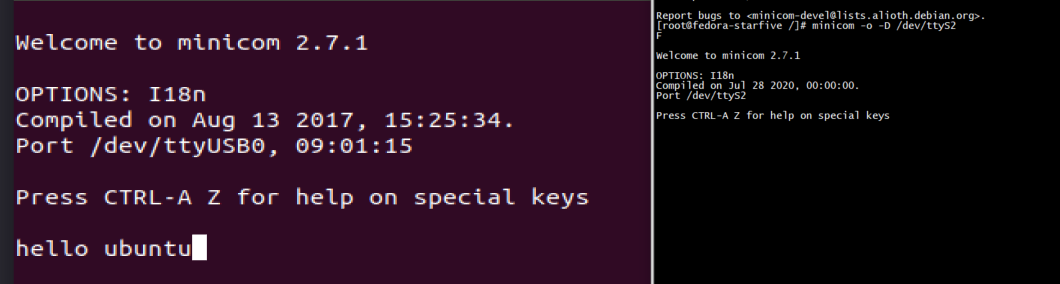

Test UART Send:
To test UART send function, you can input characters, such as hello ubuntu, on the VisionFive minicom. Then you wil see the character are outputted on the Ubuntu minicom as the following:
Figure on the Left: Ubuntu minicom interface
Figure on the Right: VisionFive minicom interface

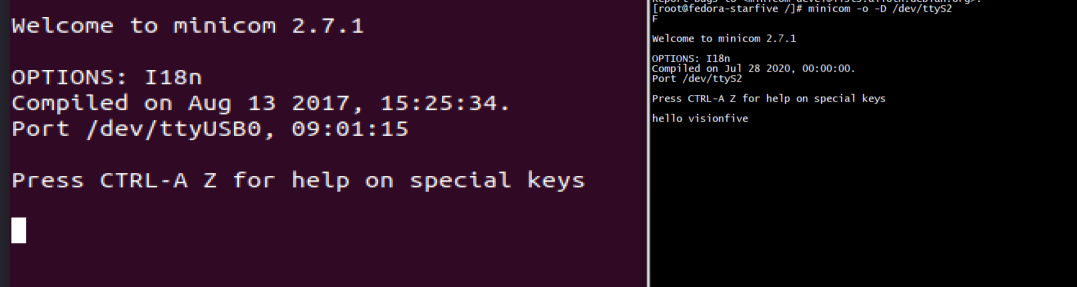

Test UART Receive:
To test UART receive, you can input characters, such as hello visionfive on the Ubuntu minicom. Then you will see the characters are outputted on the Visionfive minicom:
In this demo, Sense Hat (B) is used. For the detailed specifications, refer to https://www.waveshare.com/wiki/Sense_HAT_(B) .
Notes:
The official libraries of BCM2835, Python, and wiringPi are not supported, and we use the system call instead. The examples are required to be modified.
The following table and figure describe how to connect Sense HAT to the 40-pin header:
Table - Connect Sense Hat (B) to the 40-Pin Header
| Sense HAT (B) | Pin Number |
| 3V3 | 1 |
| GND | 9 |
| SDA | 3 |
| SCL | 5 |
Figure - Connect Sense Hat (B) to the 40-Pin Header

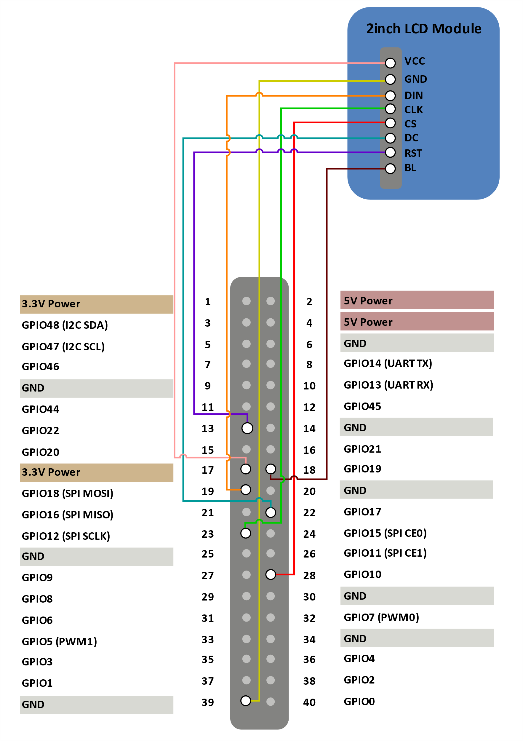

A 2inch LCD Module is used in this example. For the detailed specifications, refer to the following: https://www.waveshare.com/wiki/2inch_LCD_Module.
Notes:
The official examples are required to be modified for this demo.
The following table and figure describe how to connect the 2inch LCD module with the 40-pin header:
Table - Connect 2inch LCD with 40-pin Header
| 2inch LCD Module | Pin Number |
| VCC | 17 |
| GND | 39 |
| DIN | 19 |
| CLK | 23 |
| CS | 28 |
| DC | 22 |
| RST | 13 |
| BL | 18 |
Figure - Connect 2inch LCD with 40-Pin Header

The following two figures will be displayed in turn. One is the photo of VisionFive, the other is the offical example figure.
