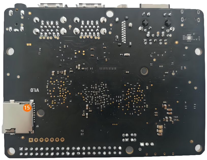

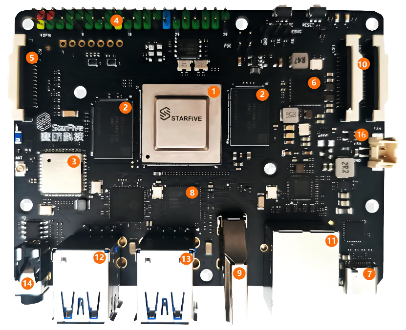

Figure - Top View of VisionFive
Figure ‑ Bottom View of VisionFive
Table ‑ Interface Description
No. | Description | No. | Description |
| 1 | RISC-V SiFive U74 Dual-Core 64-bit RV64GC ISA SoC | 9 | HDMI 2.0 Connector |
| 2 | 4GB LPDDR4 RAM | 10 | 2 x MIPI-CSI Connector |
| 3 | 2.4 GHz Wi-Fi and Bluetooth 4.2 (BLE) | 11 | Gigabit Ethernet (RJ45 Connector) |
| 4 | 40 Pin GPIO Header | 12 | 2 x USB 3.0 Host Type-A |
| 5 | MIPI-DSI Connector | 13 | 2 x USB 3.0 Host Type-A |
| 6 | PMIC | 14 | 3.5 mm Audio Jack (4-pole stereo audio output) |
| 7 | USB Type-C Connector | 15 | Micro-SD SDXC Card Slot |
| 8 | LCD to HDMI IC | 16 | Fan Header for a 2-pin 5 V Fan |

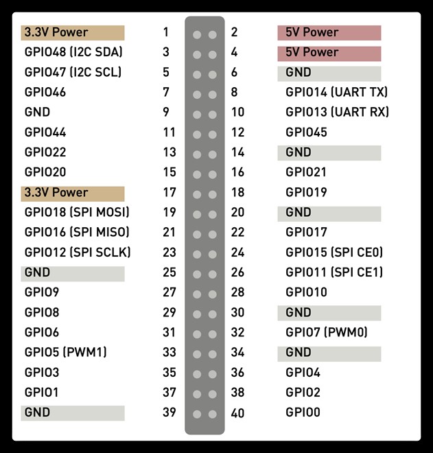

The following is the pinout diagram:
Figure ‑ Pinout Diagram
Notes:
Each GPIO pin can safely draw a maximum current of 39 mA, whereas the maximum current draw when all GPIOs are combined should be less than 100 mA. Please take this into account or otherwise you will end up destroying the GPIO pins.
All GPIOs can be configured to support different functions including but not limited to SDIO, Audio, SPI, I2C, UART and PWM.
For the instructions, refer to StarFive_40-Pin_GPIO_Header_User_Guide.

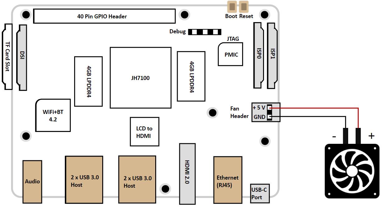

You can connect a 2-pin 5 V fan to the board as follows:
Figure - Connecting a Fan

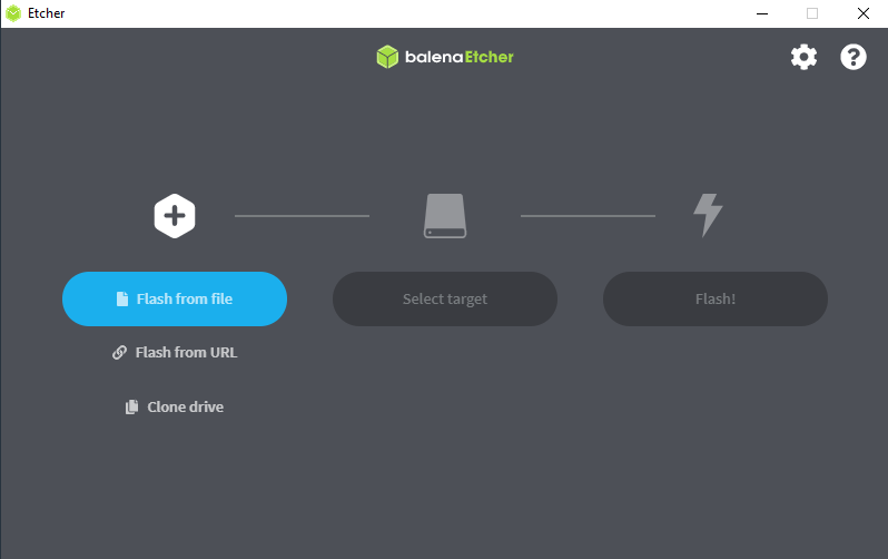

Visit this link to download BalenaEtcher. We will use BalenaEtcher software to flash the Fedora image to a micro-SD card.
Install BalenaEtcher and open it.
Figure - Install BalenaEtcher
Click on Flash from file and select the location of the image that we just unzipped:
Fedora-riscv64-jh7100-developer-xfce-Rawhide-20211226-214100.n.0-sda.raw
Click Select target and select the connected micro-SD card.
Click Flash!

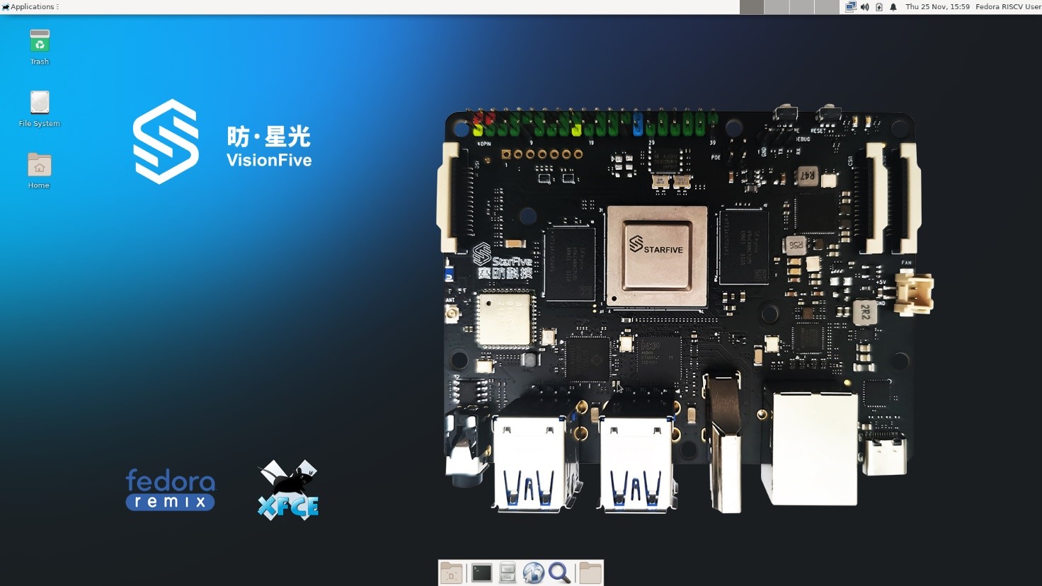

After installing Fedora, you can log in to Fedora OS on VisionFive using Xfce Desktop over HDMI.
Steps:
After the HDMI of the display screen is connected, insert the micro-SD card with the Fedora image into the VisionFive and power on.
After the desktop login system is displayed, you can use the keyboard and mouse on VisionFive.
Enter the credentials as follows:
Username: riscv (default)
Password: starfive
You will see the following interface:
Figure - UI Example

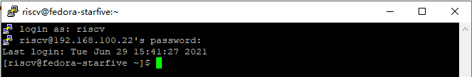

- Username: riscv
- Password: starfive
Now you have connected with the VisionFive via SSH using windows!
Figure - Example Output

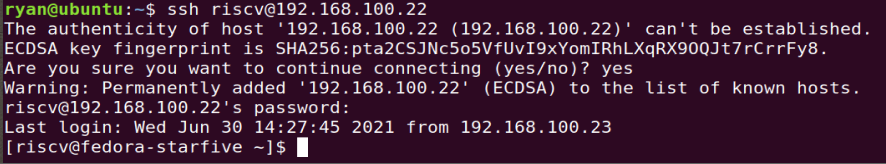

Open a terminal window and type the following:
ssh riscv@192.168.1.xxx
Information:
192.168.1.xxxis the IP address of VisionFive.
Type the password as starfive in the prompt.
Now you have connected with the VisionFive via SSH using Mac/Linux!

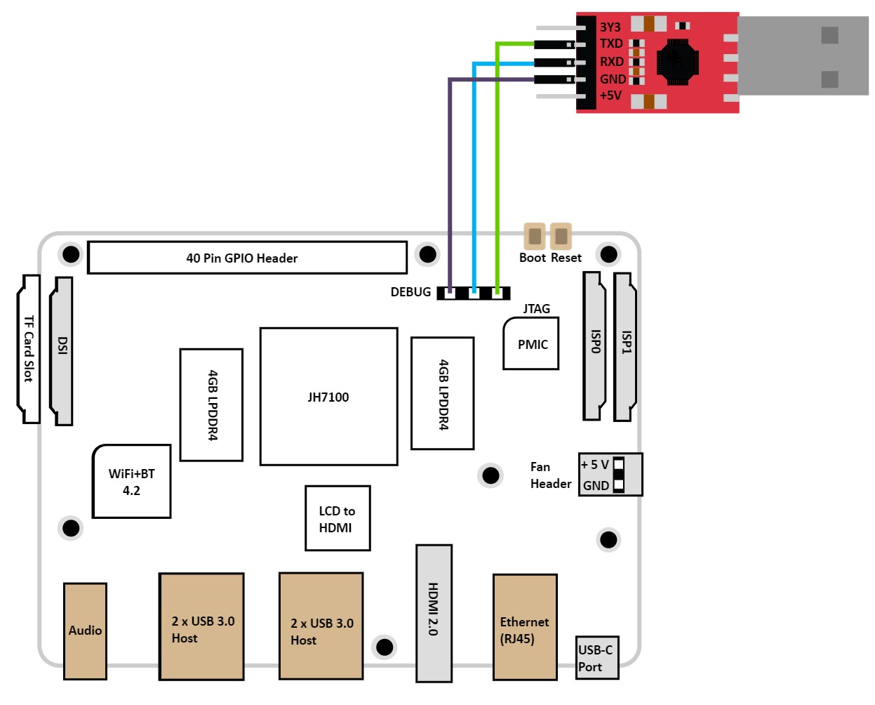

You can log in to Fedora OS on VisionFive using a USB-to-Serial converter. Please follow the following steps:
Steps:
Insert the micro-SD card with the Fedora image burnt into VisionFive.

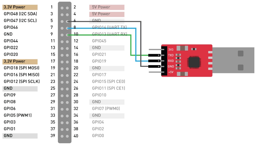

Connect one end of the USB Type-C cable to the USB Type-C port on the VisionFive, and connect the other end of the cable to the power adapter.

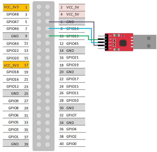

Connect the jumper wires from the USB to Serial Converter to the 40-Pin GPIO header of the VisionFive as follows.
Figure - Connecting Jumper Wire
Connect the USB-to-Serial converter to the PC.

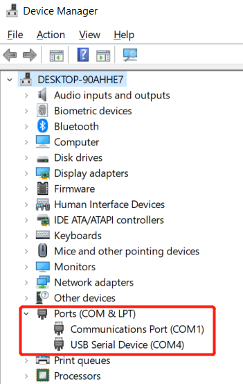

Open Device Manager by typing Device Manager in the windows search box.
Click the drop-down arrow from Ports (COM & LPT) and find the name of the connected serial port (e.g.: COM4).
Figure - Example

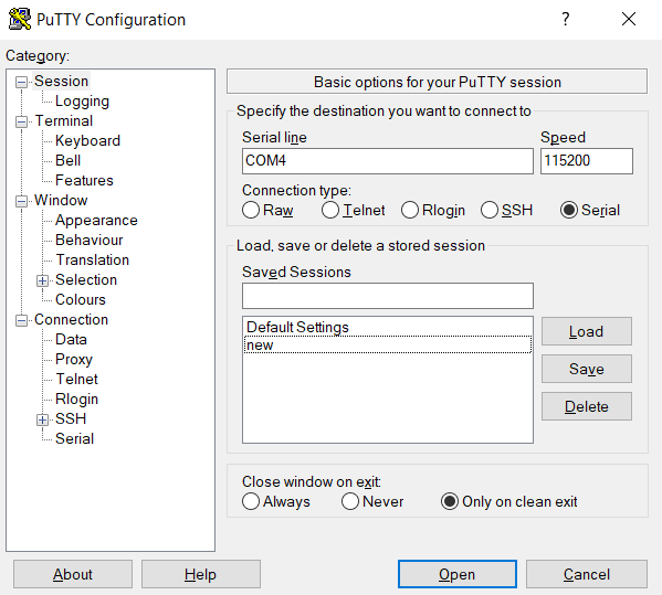

Download and install Putty by visiting this link.
Information:
Putty is an SSH and telnet client through which you can connect to the Carrier Board via SSH. You can skip this step if you already have Putty installed.

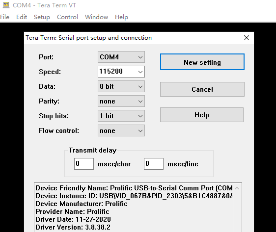

Open Putty to connect the PC to the Carrier Board.
Select Serial under the Connection Type.
Configure the settings as follows:
Serial line: COM4 (choose your COM port)
Speed: 115200
Figure - Example Configuration
Click Open.
Connect the jumper wires between the USB-to-Serial converter and the 40-Pin GPIO header of the VisionFive as follows.
Figure - Connecting Jumper Wires

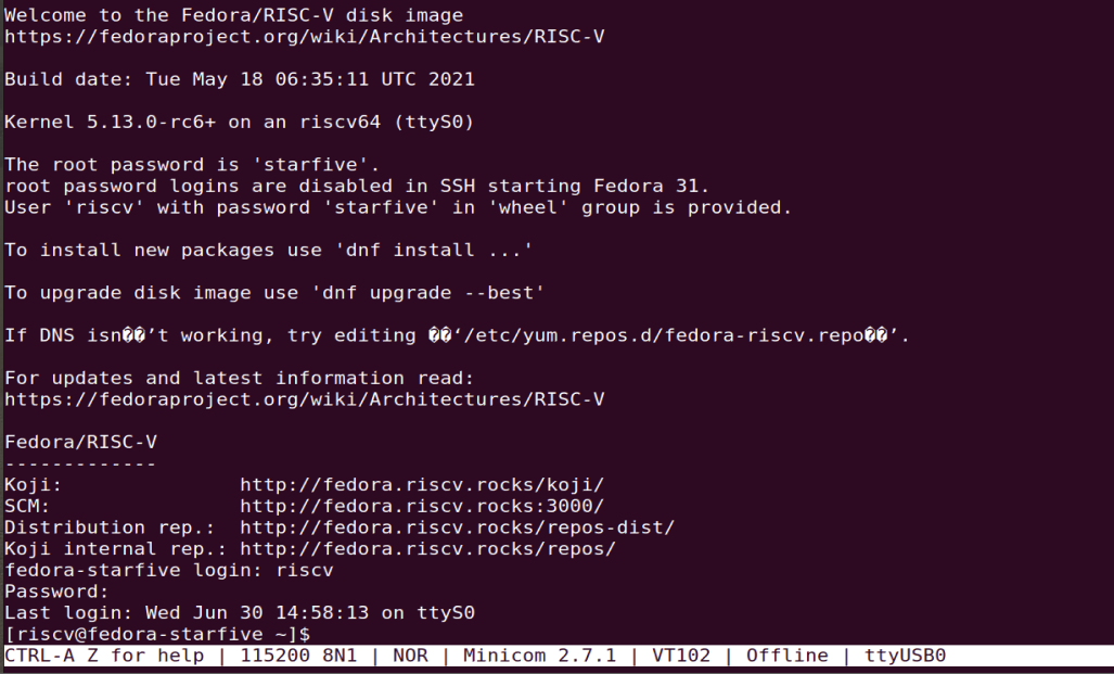

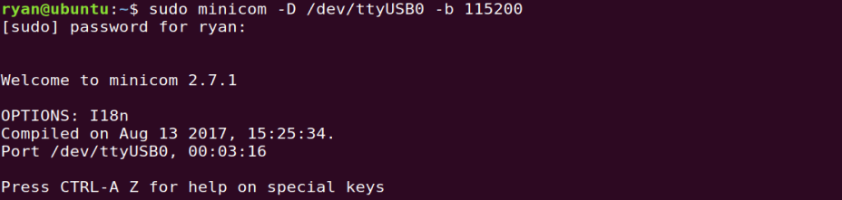

Open a terminal window on Mac/Linux.
Update the packages list by typing the following command.
sudo apt-get update

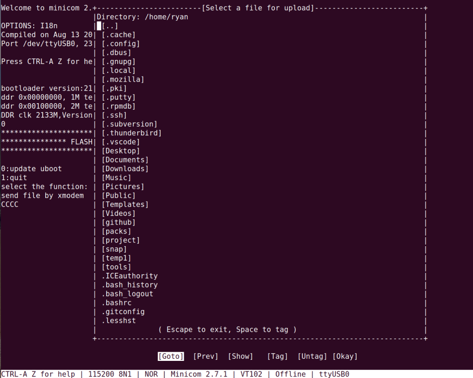

Install minicom by typing the following command.
sudo apt-get install minicom

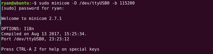

View the connected serial devices.
dmesg | grep tty

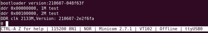

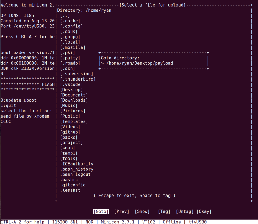

Connect to the serial device by typing the following command.
sudo minicom -D /dev/ttyUSB0 -b 115200
Information:
The baud rate is set to 115200.
Power on the VisionFive
Type username and password in the prompt as follows:

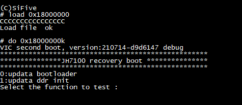

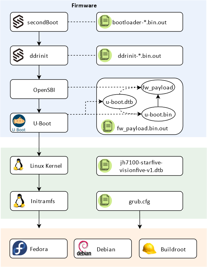

Figure ‑ VisionFive Boot Flow
Information:

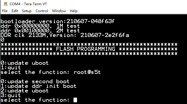

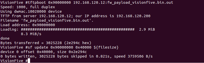

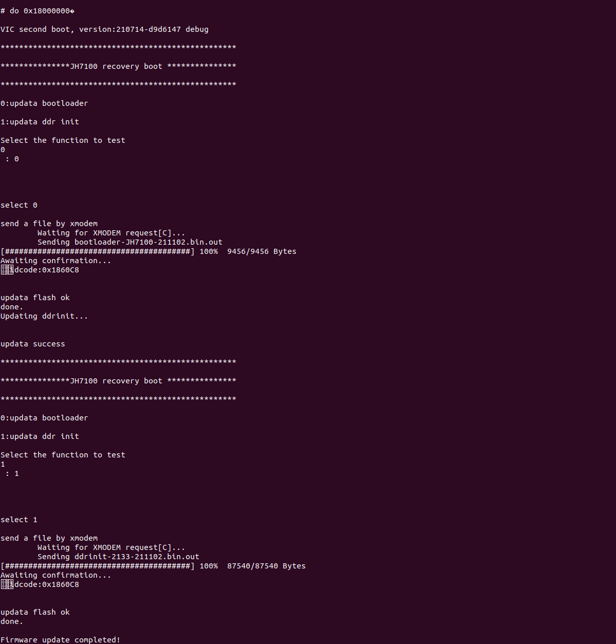

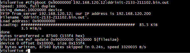

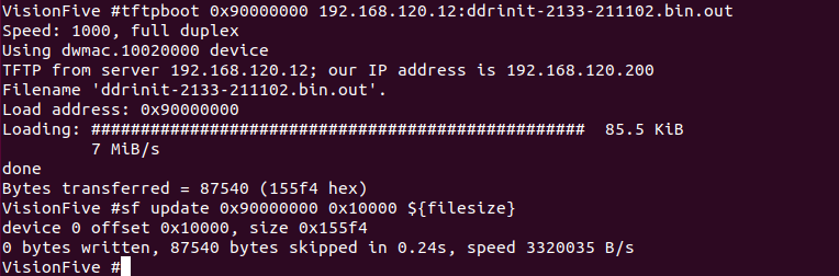

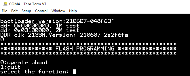

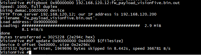

Follow the GitHub repo. Update the firmware and U-Boot if there is an update notice. Refer to the Appendix D chapter in this document for the link to the repo.
Please visit the following links to download the bootloader, ddr init and u-boot files.

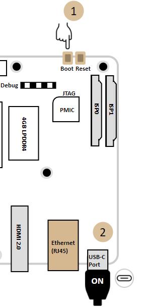

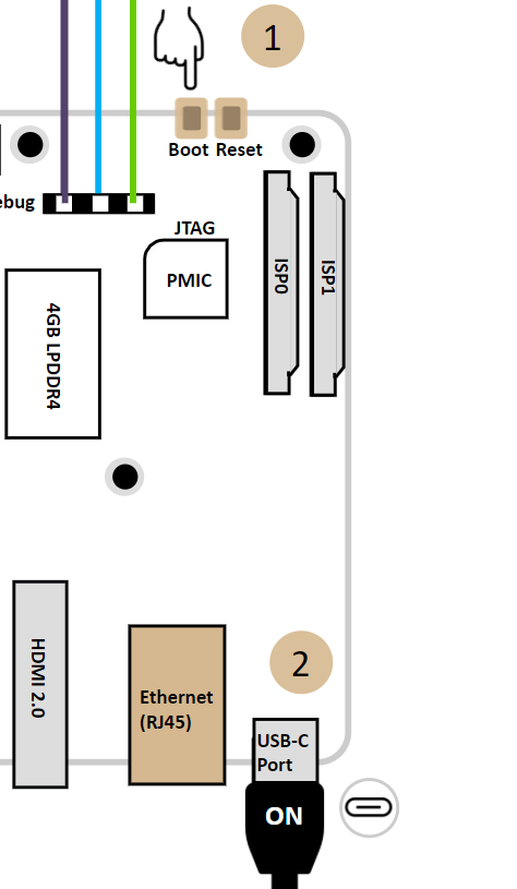

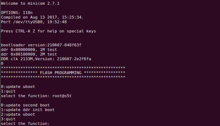

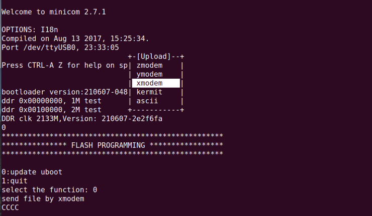

To connect hardware, perform the following:
Steps:
Figure - Connecting the Jumper Wires
Figure - Example
Open Tera Term software.
Navigate to Setup > Serial port...
Click New > open.
After the hardware connections mentioned above, power on the VisionFive and you will see the startup information as follows.
Figure - Startup Information Example
Press any key as soon as it starts up to enter the upgrade menu. In this menu, you can only update u-boot.
Figure - Update Uboot
Type root@s5t and press Enter to enter the extended version of the upgrade menu. In this menu, you can update u-boot, bootloader and ddr init.
Type 0 and press Enter to update the bootloader.

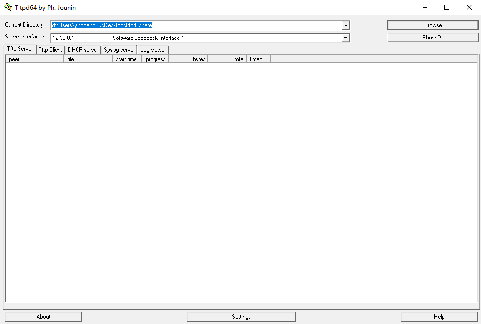

Download TFTPD64 from tftpd64.
Install TFTPD64 on your PC.
Open TFTPD64 and configure the Current Directory, which specifies the file path to store bootloader, ddr init, and u-boot files. The following figure shows an example configuration:
Example Settings

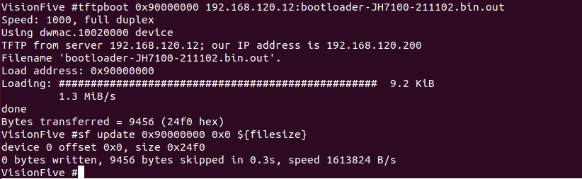

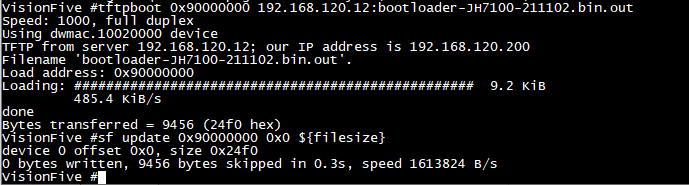

Update bootloader:
tftpboot 0x90000000 192.168.120.12:bootloader-JH7100-211102.bin.out
sf update 0x90000000 0x0 ${filesize}
Example Output:
Update ddr init:
tftpboot 0x90000000 192.168.120.12:ddrinit-2133-211102.bin.out
sf update 0x90000000 0x10000 ${filesize}
Example Output:
Update u-boot:
tftpboot 0x90000000 192.168.120.12:fw_payload_visionfive.bin.out
sf update 0x90000000 0x40000 ${filesize}
Example Output:

Connect to the serial device by typing the following.
Information:
Figure - Example
Figure - Example

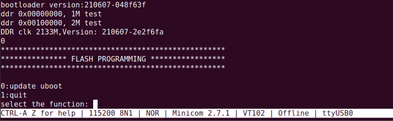

Figure - Example
Type root@s5t and press Enter to enter the extended version of the upgrade menu, and in this menu, you can update u-boot, bootloader and ddr init.
Figure - Example
Press Ctrl+A and then press S to enter upload mode.
Select xmodem and press Enter.
Figure - Example
Select Goto from the bottom tab menu and press Enter.
Figure - Example
Enter the directory path and press Enter.
Figure - Example
Select bootloader-JH7100-211102.bin.out by navigating using arrow keys, press Space and press Enter.

Update bootloader:
Example Output:
Update ddr init:
Example Output:

Information:
The methods to compile and update u-boot are included in the following: VisionFive_Software_Technical_Reference_Manual.
The bootloader is stored inside the SPI flash storage. There may be situations where you accidentally emptied the flash or if the flash is damaged on your VisionFive. In these situations, it's better to reset the bootloader. Follow the steps below to load JH7100_recovery_boot.bin to on-chip SRAM, run it, and then flash bootloader, ddr init and u-boot.
Connect the jumper wires between the USB-to-Serial converter and the DEBUG header of the VisionFive as follows.
Figure - Connecting the Debug Header
Configure the settings as follows.
Port: COM4 (choose your COM port)
Speed: 9600
Click on New open.
Press the BOOT button while turning on VisionFive.
Figure - Pressing the Boot Button

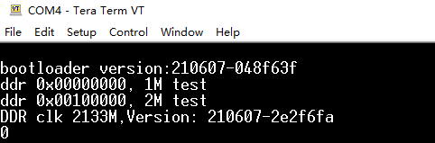

You will see the following output on Tera Term.
(C) SiFive
Type the following.
load 0x18000000
You will see an output like this:
Navigate to File > Transfer > XMODEM > Send... and choose the following file we downloaded before: JH7100_recovery_boot.bin.
You will see an output like this after the transfer is complete.
Load file ok.
Type the following.
do 0x18000000
Navigate to File > Transfer > XMODEM > Send... and choose the following file from the .zip file we downloaded before:
Repeat the steps 10 and 11 to update the ddr init according to the following.
