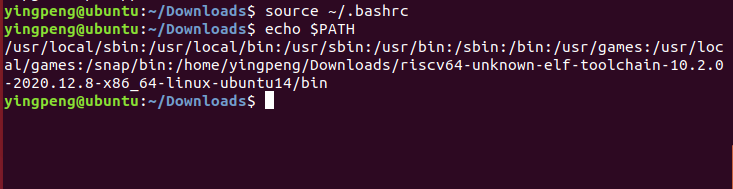

Type the following to make the change effective:
source ~/.bashrc
Command Example and Result:
The following figure shows an example command and the result:
Figure - Example Output

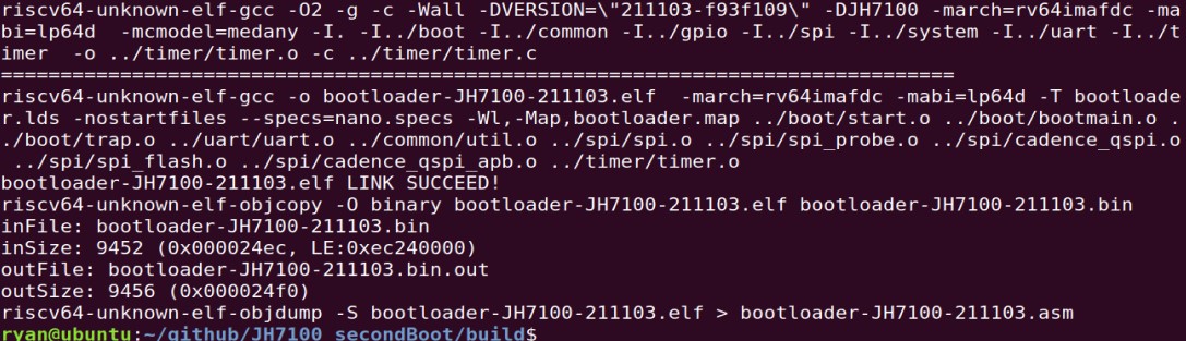

Compile bootloader.
make
You will see the following output if the compilation is successful.

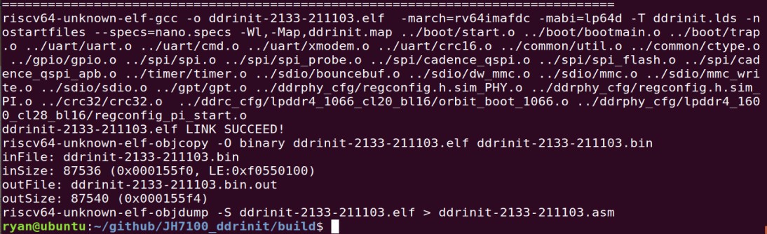

To compile ddr init, perform the following:
Steps:
Clone the repo from GitHub.
git clone https://github.com/starfive-tech/JH7100_ddrinit.git
Go into build directory.
cd JH7100_ddrinit/build
Compile ddr init.
make

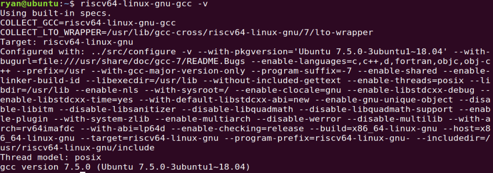

Install the riscv64-linux-gnu-gcc compiler from Ubuntu packages.
sudo apt update
sudo apt upgrade
sudo apt install gcc-riscv64-linux-gnu
Check the version of the riscv64-linux-gnu-gcc.
riscv64-linux-gnu-gcc -v
The output will be as follows:

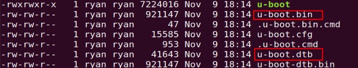

Type the following to compile u-boot under the u-boot directory.
make <Configuration_File> ARCH=riscv CROSS_COMPILE=riscv64-linux-gnu-
make u-boot.bin u-boot.dtb ARCH=riscv CROSS_COMPILE=riscv64-linux-gnu-
Information:
Configuration_File:
- For VisionFive, the file is
starfive_jh7100_visionfive_smode_defconfig.- For Starlight, the file is
starfive_jh7100_starlight_smode_defconfig.
There will be these 2 files generated after compilation inside the u-boot directory: u-boot.bin and u-boot.dtb.
Information:
Bothu-boot.dtbandu-boot.binwill be used later for OpenSBI compilation.

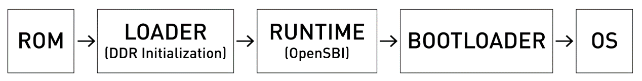

OpenSBI stands for Open-source Supervisor Binary Interface and it is an open-source implementation of the RISC-V Supervisor Binary Interface. It is a RISC-V specific runtime service provider and it is typically used in boot stage following ROM and LOADER. A typical boot flow is as follows:
Figure Typical Boot Flow

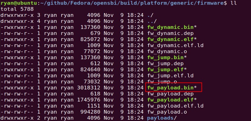

make ARCH=riscv CROSS_COMPILE=riscv64-linux-gnu- PLATFORM=generic FW_PAYLOAD_PATH={U-BOOT_PATH}/u-boot.bin FW_FDT_PATH={U-BOOT_PATH}/u-boot.dtb
Information:
Modify the {U-BOOT_PATH} to the path of u-boot from before.
After compilation, the file fw_payload.bin will be generated in the directory opensbi/build/platform/generic/firmware and the size is larger than 2M.

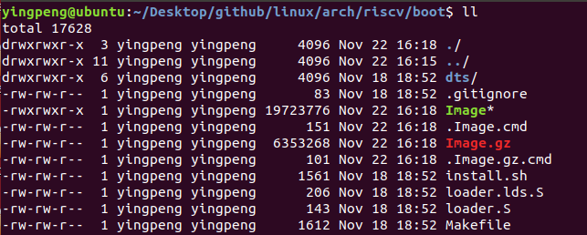

The kernel image will be generated inside the directory linux/arch/riscv/boot as Image.gz.

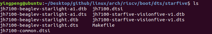

The dtb files will be generated inside the directory linux/arch/riscv/boot/dts/starfive
Figure - Generated dtb Files

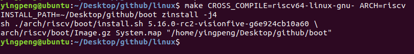

Compile the file under the linux directory with the following command:
make CROSS_COMPILE=riscv64-linux-gnu- ARCH=riscv INSTALL_PATH=<ROOTFS_PATH> zinstall -<jx>
Information:
<ROOTFS_PATH>: This is a user-defined directory where the vmliunz files will be generated.<jx>: It refers to the number of cores in your CPU. If your CPU has 8 cores, change this to -j8.
Example Command and Output:
Figure - Example Command and Output
vmliunz files will be generated under the ROOTFS_PATH.

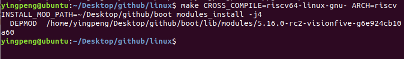

make CROSS_COMPILE=riscv64-linux-gnu- ARCH=riscv INSTALL_MOD_PATH=<ROOTFS_PATH> modules_install -jx
Information:
- If you need to add new modules, this step is required.
<ROOTFS_PATH>: This is a user-defined directory where the modules will be generated.<jx>: It refers to the number of cores in your CPU. If your CPU has 8 cores, change this to -j8.

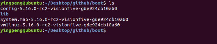

The module files will be generated under the ROOTFS_PATH.
View the files generated under ${ROOTFS_PATH}. The following is an example:
Figure - Example

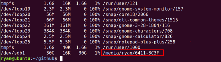

View the SD-card information.
df -h
Figure - Example SD Card Information

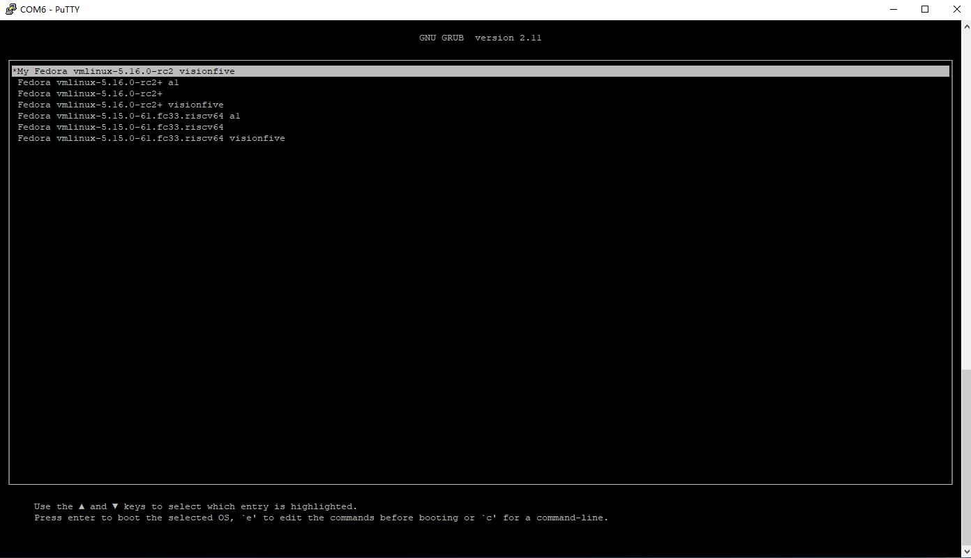

Verification:
The following steps are provided to verify if the configuration is successful:

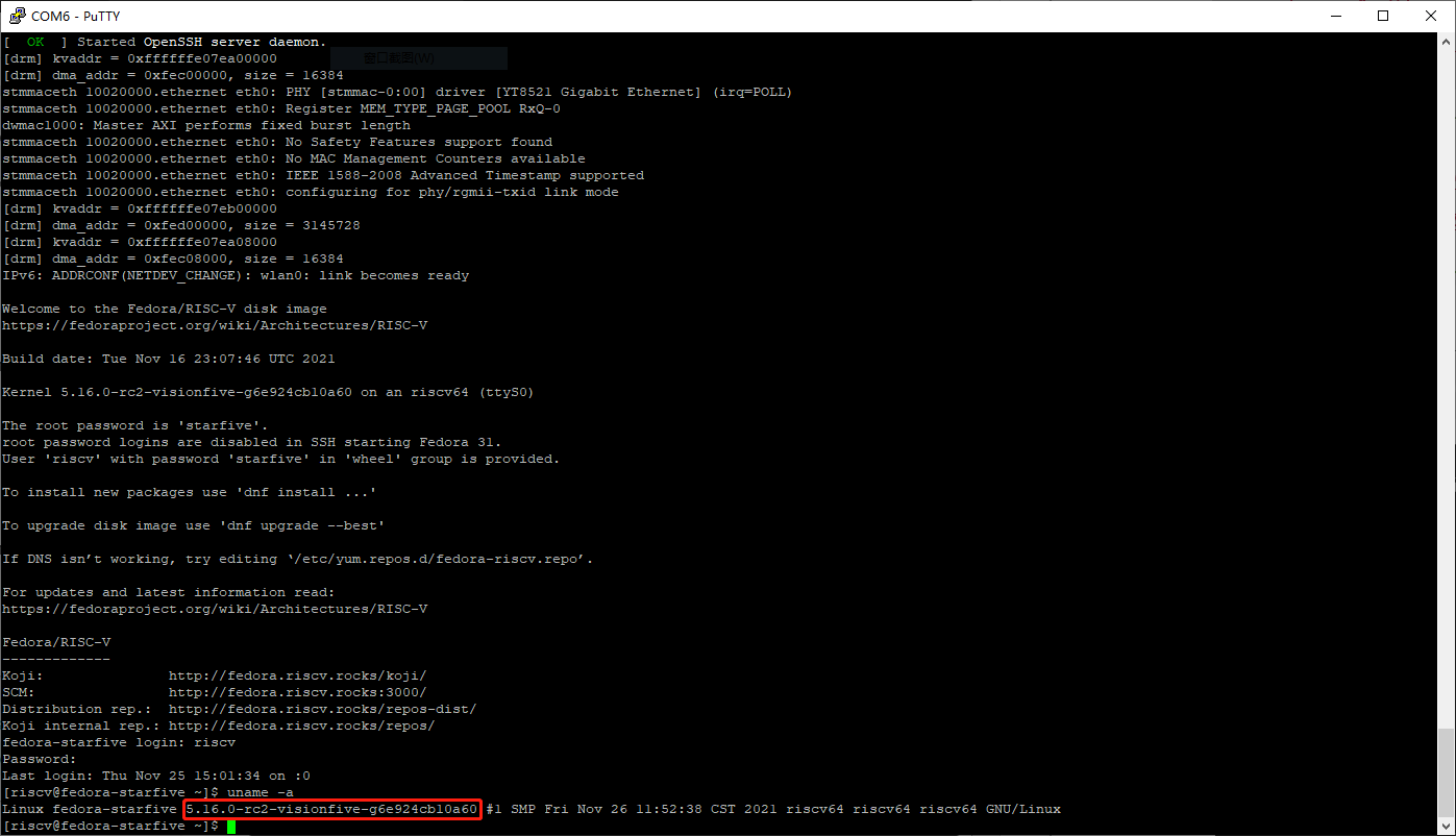

Pull out the card from the PC and insert it into the VisionFive board. The system will start normally after power-on.
You can find the defined configuration item, for example, My Fedora vmlinux-5.16.0-rc2 visionfive, on the menu, as shown below:
Figure - Example Interface
After the system starts successfully, you can see the version of the new vmlinuz file:

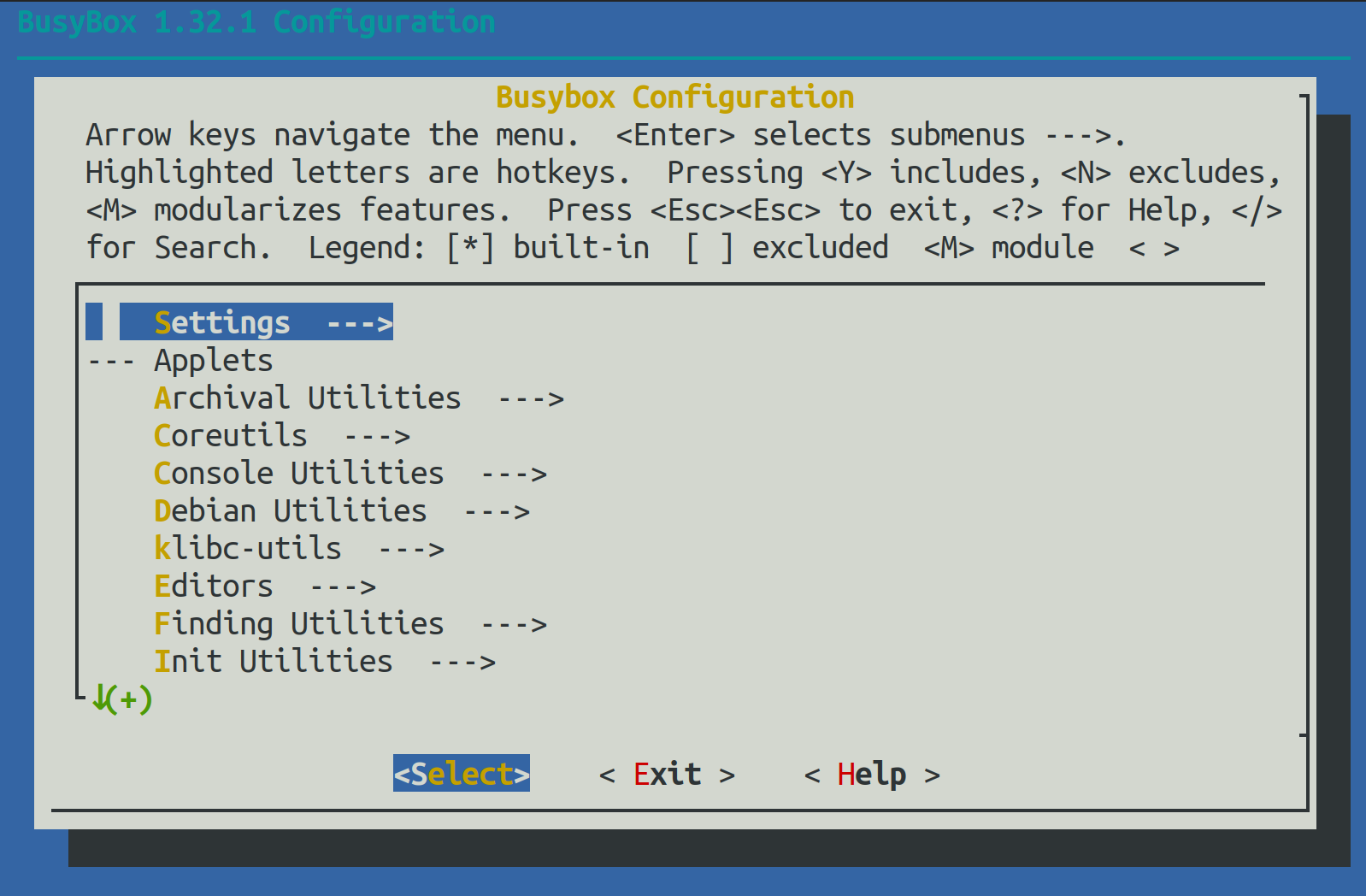

Download the busybox source code outside the rootfs directory.
git clone https://git.busybox.net/busybox
Navigate to the extracted location and enter busybox configuration.
cd busybox
make CROSS_COMPILE=riscv64-linux-gnu- ARCH=riscv menuconfig
Figure - Busybox Configuration
Navigate to Settings > Build Options and check Build static binary (no shared libs) by pressing Y.
Under Build Options, select cross compiler prefix and type the following to specify the compiler.
riscv64-linux-gnu-
Under Installation Options > Destination path for make install, change the path to the path of the rootfs file directory (this is the installation location of the compiled busybox).
Example:
/home/user/rootfs
Exit from the busybox configuration window and save the configuration.

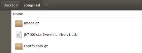

Start by moving the previously compiled rootfs file system package, kernel and dtb images into a single directory.
<dtb_File_Name>: Different boards use different dtb files, and for the detailed information, refer to the dtb Files table in StarFive_40-Pin_GPIO_Header_User_Guide.

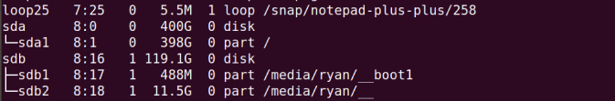

Insert a micro-SD card to the host PC.
Type the following to see the location of the connected micro-SD card.
lsblk
For example, it's /dev/sdb.

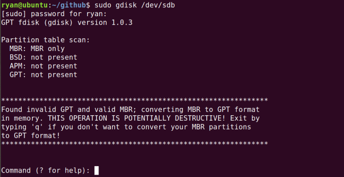

Type the following to enter the partition configuration.
sudo gdisk /dev/sdb
Example Output:
Delete the original partition and then create a new partition by entering the following respectively.
d--->o--->n--->w--->y

Remove the micro-SD card from PC and plug again to mount it.
Enter the following to check whether it gets mounted.
df -h
You will see an output as follows and take a note of the mount location.

Remove the micro-SD card from PC, insert into VisionFive and turn it on.
Open minicom while USB to Serial Adapter is connected between VisionFive and PC, and wait until the board enters u-boot mode. You will see the following output when it is in u-boot mode.
.jpg)
Enter the following commands.
setenv kernel_comp_addr_r 0x90000000;setenv kernel_comp_size 0x10000000;setenv kernel_addr_r 0x84000000;setenv fdt_addr_r 0x88000000;setenv ramdisk_addr_r 0x88300000
fatls mmc 0:1
fatload mmc 0:1 ${kernel_addr_r} Image.gz
fatload mmc 0:1 ${fdt_addr_r} jh7100-starfive-visionfive-v1.dtb
fatload mmc 0:1 ${ramdisk_addr_r} rootfs.cpio.gz
booti ${kernel_addr_r} ${ramdisk_addr_r}:${filesize} ${fdt_addr_r}
Log in by typing the following credentials.

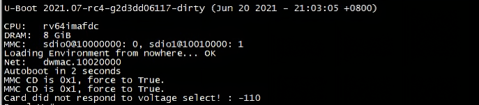

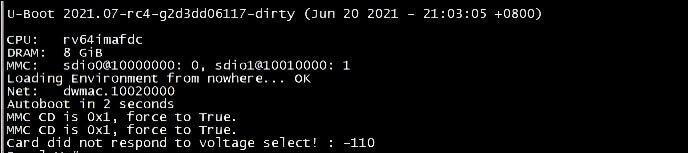

Open minicom and wait until the board enters u-boot mode. You will see the following output when it is in u-boot mode.
.png)
